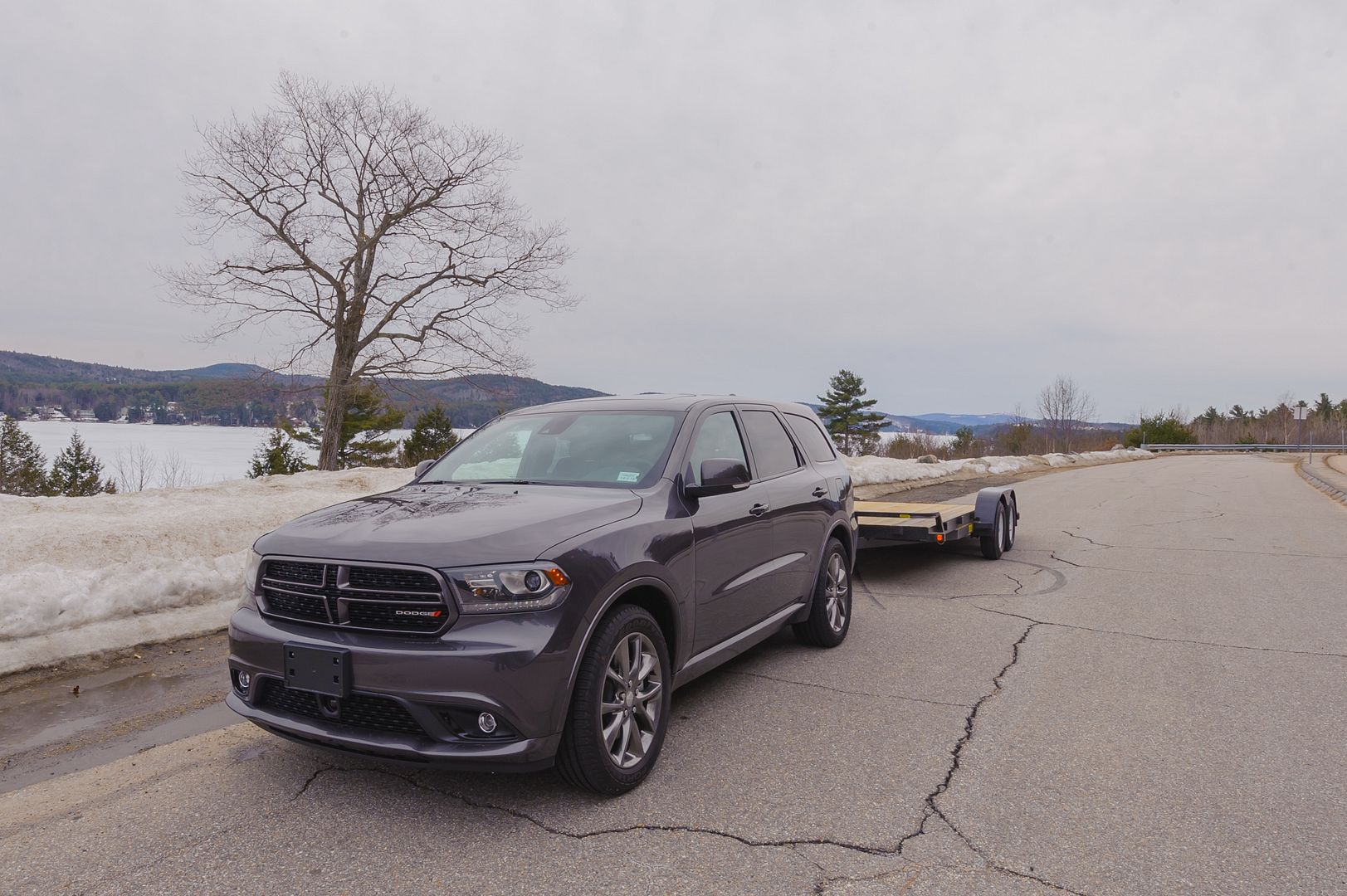

Ok, so I've put over 1000 miles on the clock with about 6500lbs on the bumper and I've got another 1000 or so to go. Here's what I've noticed so far:
Drivers on American Interstates are about some of the most inconsiderate, oblivious people in the world. Not "bad" drivers like I've experienced in other countries but rather rude, self-important, entitled drivers with no consideration for the people around them. I've thoroughly tested the brakes with panic stops because people like to pull in front of people towing. I've had to test the sway control by jerking out of the way of someone waiting until the last possible second to swerve to the off ramp from the far left lane. The V8 and 8spd have been tested when 2 cars decided to go 55 in a 70 and block off everything except the far left lane on 2 mile hill on I-75 South. Idiot drivers irritate me but they have also tested the Durango as a tow vehicle in ways that an uneventful drive never would have.
The P3 is solid. I don't have any other experience to compare it to, but the P3 controls the trailer nicely. The "boost" feature is probably a little strong, even on B1, for the weight I'm pulling, but I turned the boost off and the trailer brakes just felt a little too soft. I kept it set on B1 and just modified my braking based on how the B1 setting had been working. Maybe there's a way to adjust the settings to achieve a B1/2, but as a plug-and-play I NEVER worried about my trailer brakes giving out or the trailer passing me when I hit the pedal.
The Durango is well equipped to handle towing an open car trailer with a 2006 Dodge Magnum. The trailer isn't as invisible as if this was a Ram 2500 Mega Cab with the Cummins. I can definitely feel the trailer back there, but it doesn't turn the truck into a complete slug. Cruising along with the eco mode on and my truck tuned with the Diablo Intune (87 Octane tune to save a few pennies on the highways), I have been averaging about 11 mpg on a drive from New Hampshire to Ohio to Kentucky to Georgia. The transmission shifted smoothly and always seemed to be right where it should be and the engine is strong enough.
When I took the trailer off the truck, it REALLY woke up. I can't wait to get some good gas and a healthier tune to run this thing as a daily driver--but for all the utility I've needed it's been great.
#26 ·
We stopped along the road from Tilton, NH to Rochester, NH (overlooking Lake Winnisquam) after picking up the trailer.
