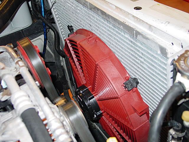

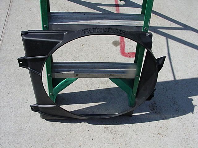

I ordered a one piece Fan Shroud and modified it to fit a 3600 RPM electric fan then ordered the FF Dynamics FF85 Fan and installed it.
The shroud

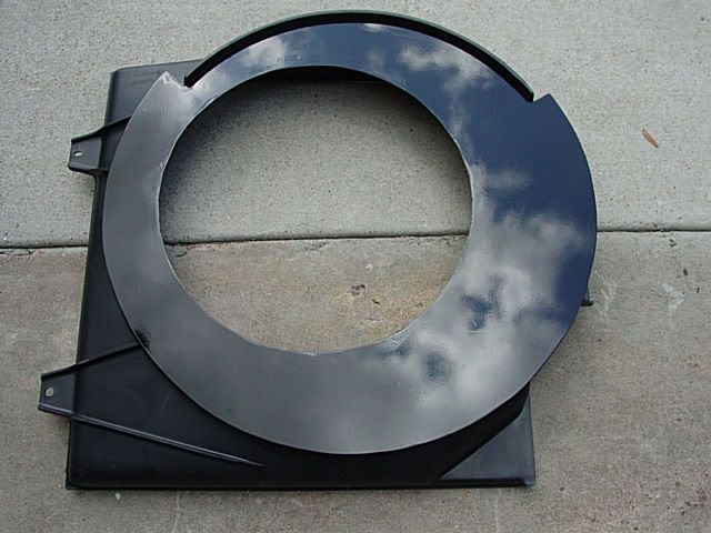

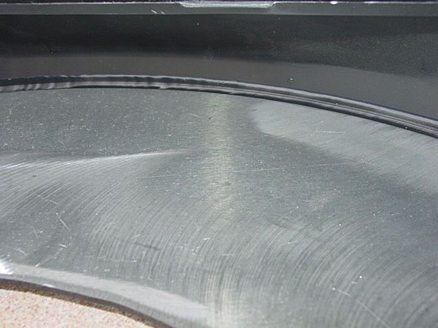

I made a pattern from cardboard that my buddy used to cut a piece of aluminum (I offset the hole so the fan would sit centered over the radiator.)
Shot it with self etching primer.
Setting on the shroud.
Painted it black.

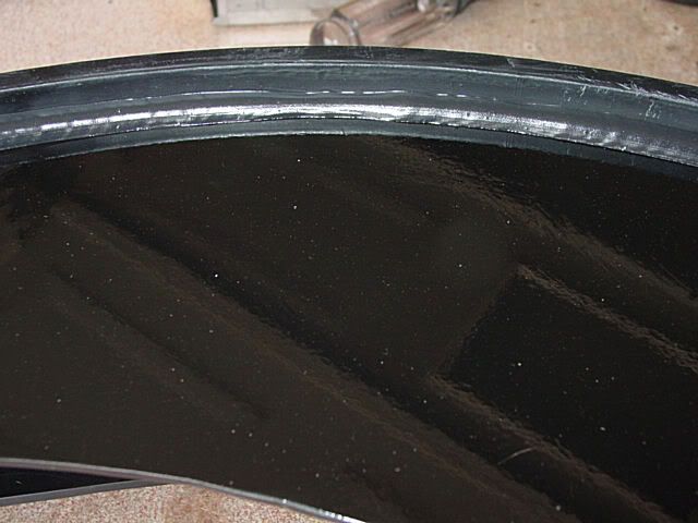

Attached it to the shroud using black polyurethane to seal around the edges both inside and out.
I had to put the fan "inside" the shroud so it wouldn't hit the pulleys and also polyurethaned it in place.
Outside view
Before
After
Works great and helped cool things down, but with +100? heat for the last 18 days straight and no rain in sight, things still run warm around here. :twisted:

:clap: Very nice setup but I have a suggestion. What you've done is enclosed the fan and it's not as efficient that way. Add some fins to the mounting plate, similar to those on window air conditioners, to allow the air that's being forced into the front to pass thru the radiator and your fan enclosure.
IndyDurango said:
Looks good, really great in fact!
However? I think you have effectively reduced the cooling because of the lack of free flow air you'd get around the fan itself.
Let me know how it works?
IndyD
The shroud will help, having it out in the open is worse. You want the fan to pull air across the entire radiator, which it'll do with a shroud covering the entire surface. As it was, it was just pulling air thru the center and, even worse, pulling some air through the sides.
Why do you think all OEM vehicles have shrouds? If your opinion is indicating a higher speed air flow may be restricted, that can somewhat be the case, but the cooling system is the most taxed at slow vehicle speeds.
Radiator Tips<blockquote class=quote>2. Thou shall shroud thy radiator when using a fan.
Fans move air through the radiator assisting in cooling the engine. A fan without a shroud is better than no fan, but consider this. At idle or cruising speeds, you need the entire cooling system working at its optimum. An unshrouded fan is moving air through only the portion of the radiator equal to the surface area of the fan. For example, on a ?32 Ford, the area of a 15.50? fan is about 189 sq. in.; the core of the radiator is approximately 371 sq. in. This means that almost 49% of the unshrouded radiator isn't receiving any benefit of the fan. Shrouding your radiator lets the fan pull air through the entire core.</blockquote>
They have shrouds, HOWEVER, shrouds that are NOT flush against the radiator face. Almost always they funnel away heat from a gap that's between the back side of the radiator before getting to the shroud. Most have a few inches and that extra air is the free flow missing from a setup like this.
IndyD
There's plenty of distance off the surface of the radiator to allow the effect you speak of above.
He may want to cut some flapped bypass vents in the surface to allow air flow thru there while moving at a good pace, but the fan will do all the work in traffic.
It's doubtful the fan itself will move as much air as stated above. The only fan I can find that looks like that only moves about 2000 CFM max.
