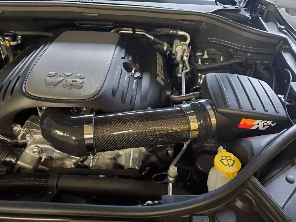

hashbr0wnz: " The only thing i deviated at was placement of the IAT sensor. By moving that to the airbox top hat (as far away from the engine block as possible) I'm reading near ambient air temps and getting better gas mileage. 2-3 mpg to be ballpark. "
Could you please provide a photo of the placement of the IAT sensor, as I don't see it in your 2 images (or may not know where to look :)
Thanks

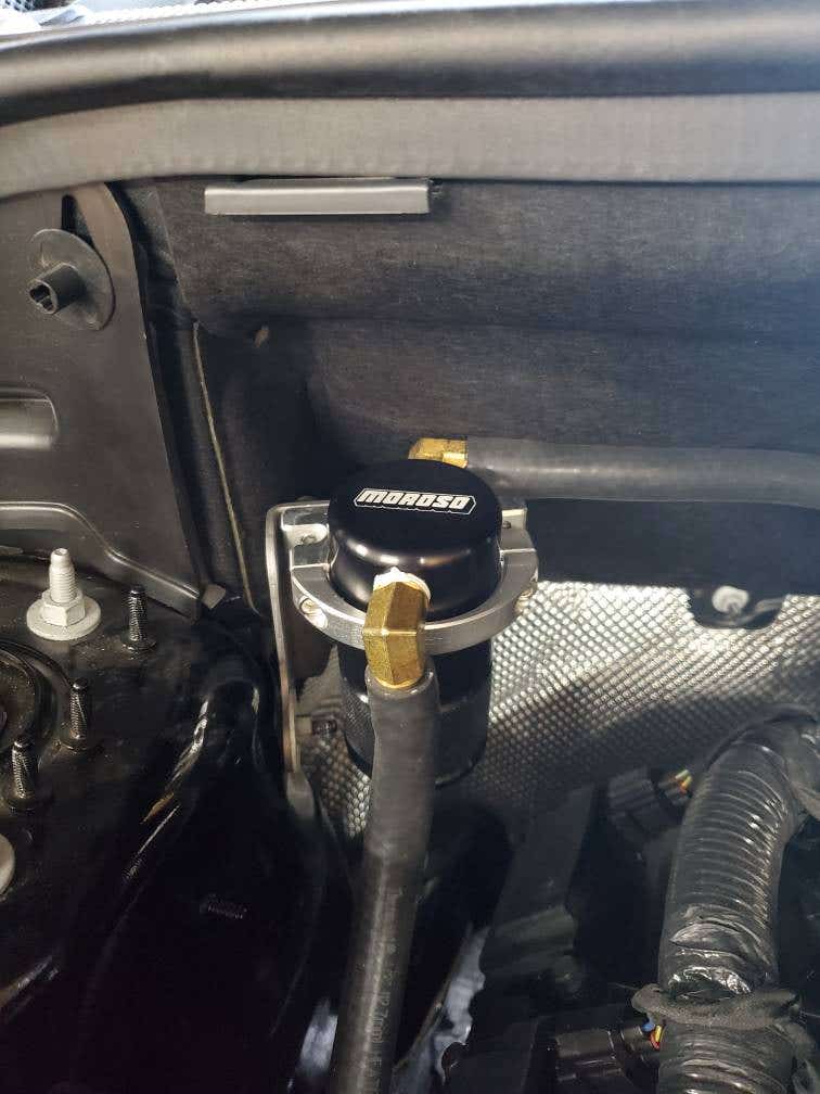

LD2335: Did the "Catch Can" come with hoses? And/or what source/specifications did you use? BTW great looking installation!
Thanks
Preben
[/QUOTE]
I bought a $119 Billit catch can on ebay. It came with all the fittings and hoses plus the bar to install it on the side of the ECM. I feel like it's a must for the hemi to keep that oil out of the intake

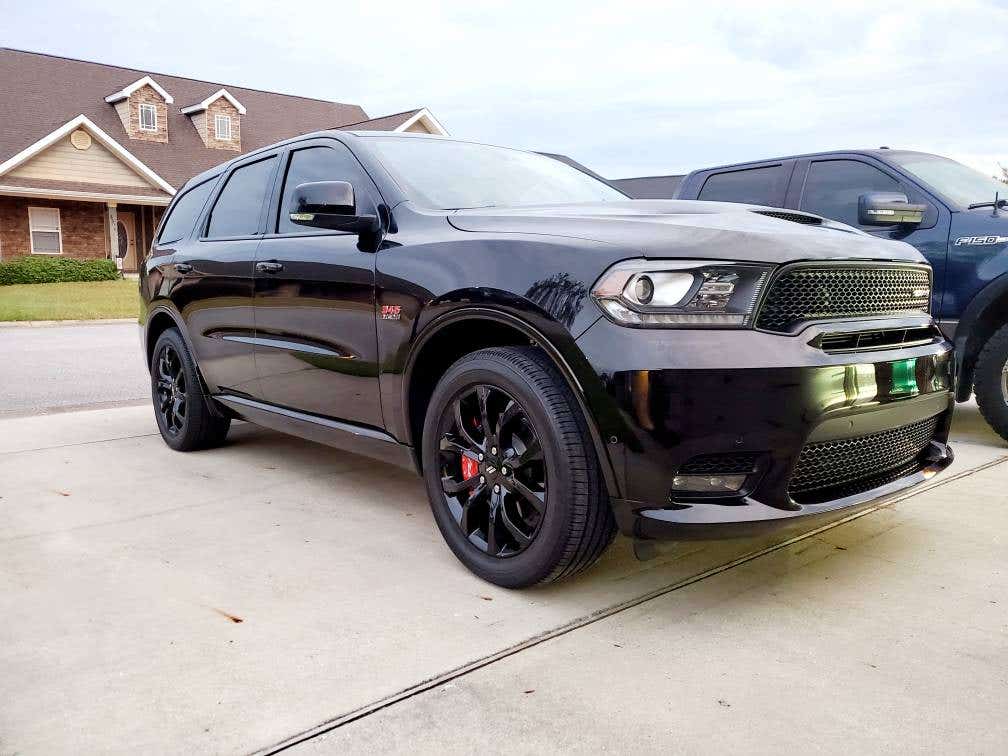

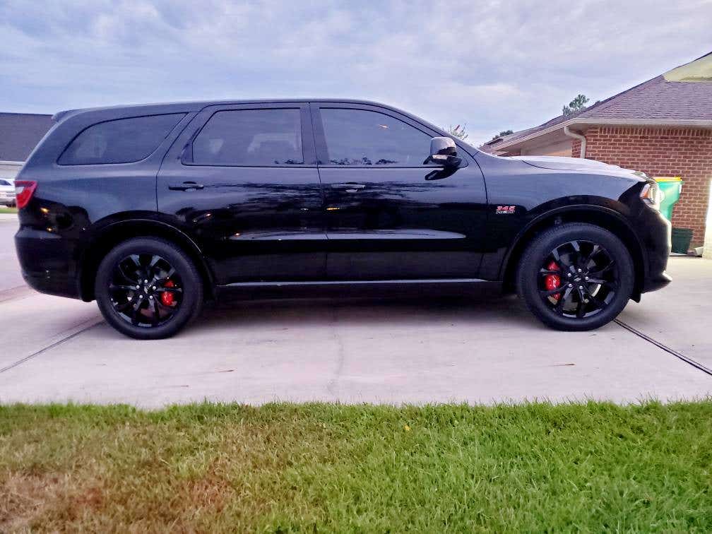

Here goes. 2019 R/T Blacktop (it's the wife's daily driver)
1. Window tint - 20% Madico black pearl ceramic Ir film
2. 345 hemi fender badges - https://www.amazon.com/dp/B07K29V6QT?ref=ppx_pop_mob_ap_share
3. R/T Emblem Overlay Decal -https://www.amazon.com/dp/B01M9IRK8W?ref=ppx_pop_mob_ap_share

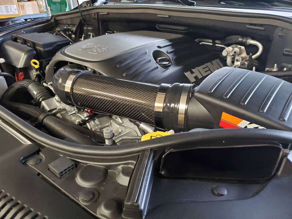

4. Custom Carbon Fiber Intake/K&N Filter
-- Carbon fiber 4" tube - https://www.amazon.com/dp/B074K7G3S9/ref=cm_sw_r_cp_apa_i_2nSsDbT5RHX52
-- 4" straight hump coupler
-- 3.5" to 4" 90 Degree coupler
-- 1" od/1/2" ID grommet for IAT sensor
-- K&N drop in filter 33-2457

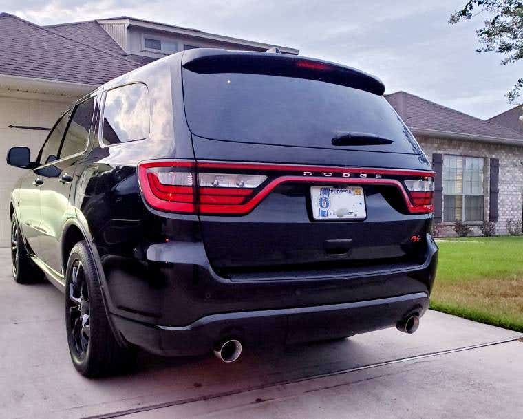

6. Exhaust tips - Flowmaster Double wall 4" 15396 2.50" Inlet Polished Stainless Steel Angle Cut Exhaust Tip - Amazon.com: Flowmaster (15396) 3.50" Polished Stainless Steel Angle Cut Exhaust Tip: Automotive

10. Moroso 85613 Air/Oil Separator, Black Amazon.com: Moroso 85613 Air/Oil Separator, Black: Automotive

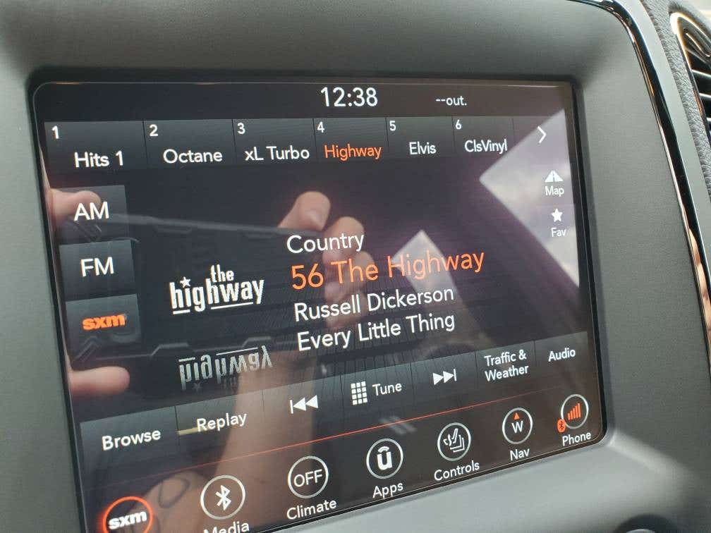

11. 8.4" Uconnect Screen Protector (love the feel of it. Feels like a real tablet screen) I do wish it was a few mm bigger. https://www.amazon.com/dp/B073JPP68M?ref=ppx_pop_mob_ap_share
