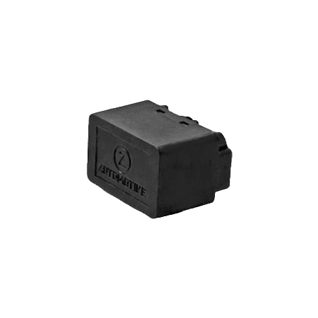

interesting solution, does this unlock the main service obd port for diablo/hemifever/alpha/tazer to work?
the zauto bypass which would work for alpha as well just needs a white and green canbus wire input from a breakout bus. the diablo video shows what looks like a programmed module to fake the gateway module. what do they charge for it?
UC5 radio was just added to the Tazer beta as well...
#38 ·
I just bought the zAuto security module and plugged it in under the dash on the passenger’s side.
What’s the difference between that and this double bypass thing?
#39 ·
#41 ·
ahhh ok sorry...its thanksgiving in Canada and Ive had a few pops 😆 thats the pre 2018 charger/challenger bypass method
So I guess the 2018+ durangos dont need the "double bypass" which is what the 2018+ charger/challengers require, which is essentially a wire harness for an obd port that you jack into a can bus connector bus in the trunk..unless its a completely different product but looks the same initially..
Im going to try the double bypass on the TnG when I get a chance, or maybe talk to ZAuto about it since I have a line of contact open currently with the beta testing🙏🏼
I know I can find a canbus opening somewhere 😇
#40 ·
$70 from zAuto

For the 2023 Durango, you don't need anything in addition to AlfaOBD and the interface cable (or BT module) to connect and pull a log of the BCM.
You do need a security bypass solution if you want to write back to it though. I use the zAutomotive securtity gateway bypass module for AlfaOBD. HPTuners uses the Smart Access Cable solution, and when I asked them if the zAutomotive bypass would work for VCM suite, they said it would not and I would need the Smart Access Cable for VCM Editor.

I'm not sure if the double bypass cables will work on the Durango, but I know the security bypass module type does. To connect adn read, you don't need the security bypass though. You can read the ECU with HPT as well as the BCM with Alfa without it. You just can't write back to it if you don't have a bypass module.
To write back to the BCM using AlfaOBD, the security bypass module from zAutomotive works well and is easy to install.
Strange Alexey didn't recommend the zAutomotive one, as it's one of the recommendations listed on his site.
To write back to the PCM using HP Tuners, you need their Smart Access Cable and a modified (ie: unlocked) PCM.
