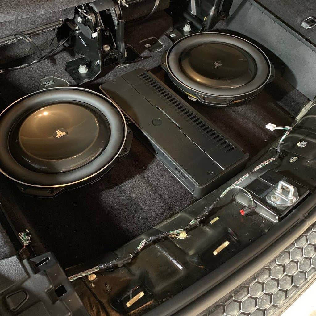

2 JL Audio 13TW5v2 Subwoofers
JL Audio RD1500 Mono Block Amplifier
JL Audio Fix-86 OEM Integrating DSP
And A XD-PCS2-2B: 2 Amp 2 Gauge Amp Kit

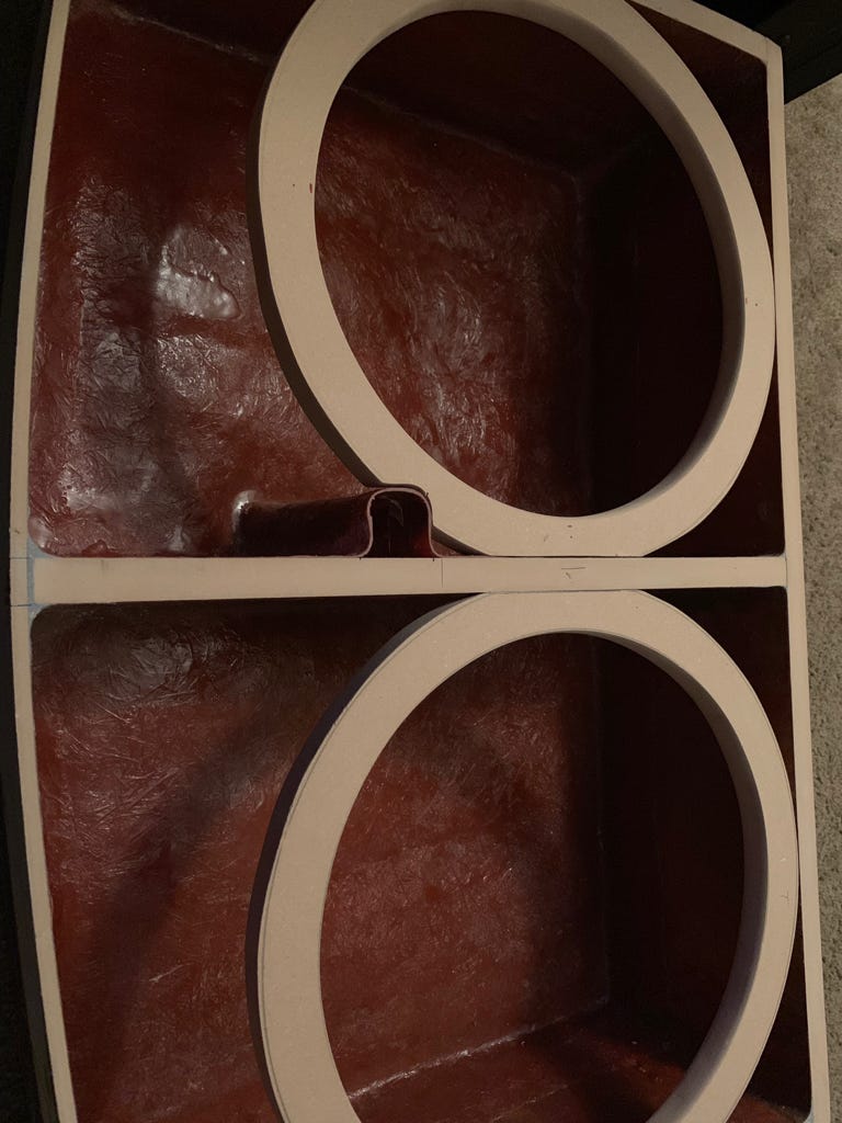

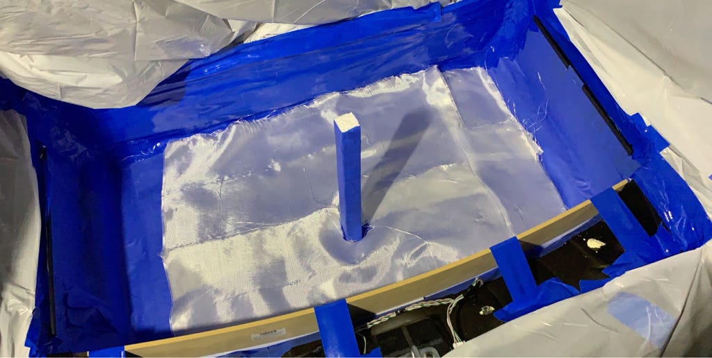

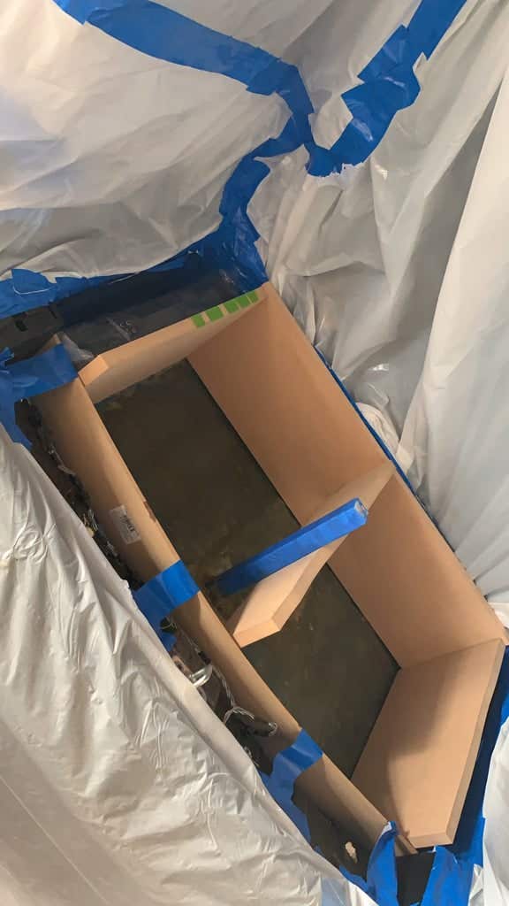

I ended up going with this layout simply to maximize enclosure size. I knew I had to fiberglass a box and quickly began gathering as much information on FG boxes as I could.

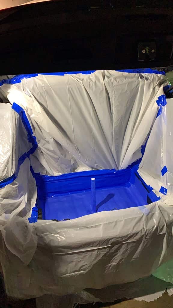

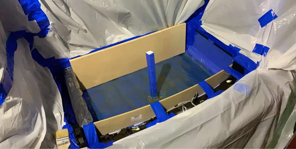

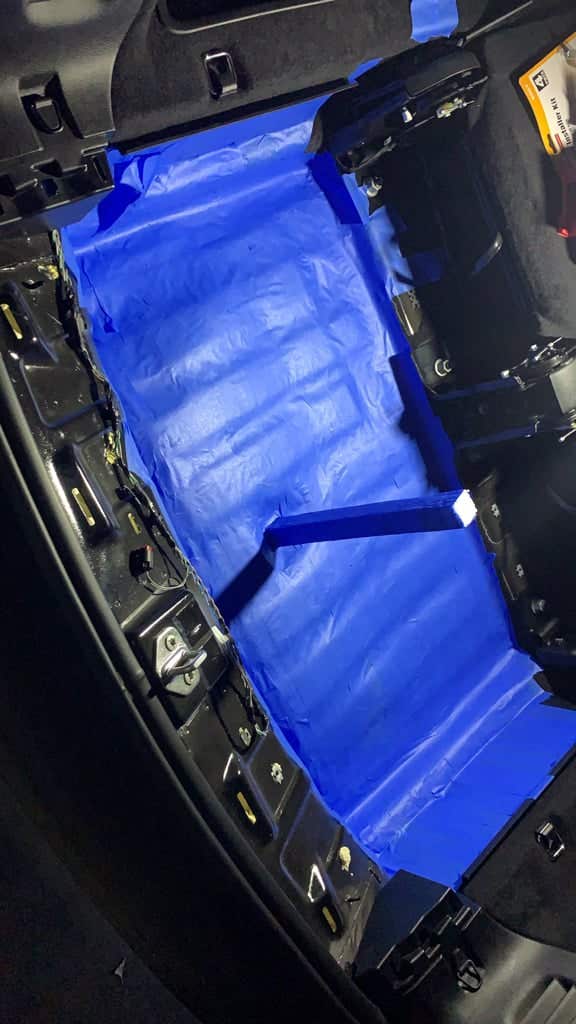

I had never worked with fiberglass and once I got started I realized I was in over my head but I was already in too deep! I taped everything off and mounted a piece of styrofoam to create a pocket for the spare access. I was nervous of the resin vapors taking away my new leather smell so I was extra cautious and went a little overboard haha!
I Laid out my vision and just ran with it, I rough cut my mdf and mocked it up and started glassing.
I got a little overwhelmed and tired of glassing at some point but fast forward and the box pretty much now finished I just need to sand and decide on a finish I will post pictures later but this is close to what I ended up with.

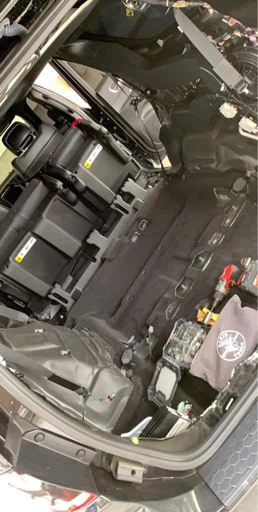

Today I spent a majority of the day TEARING the Durango apart everything I was scared to do I did lol after a month + into this project I felt myself procrastinating just being overwhelmed and it’s not going to finish itself so I jumped in! Here’s what we have now.
I will say after turning the Durango into a Jeep Grand Cherokee removing the 3rd row that has been folded down the whole 6 months I’ve had the car has me wishing I went a different route but after all this time fabricating the fiberglass box IM USING it haha.
