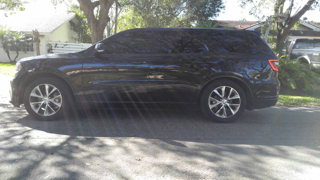

So I just got them installed. They are correctly installed and not reversed. As you can see my front end is much higher than stock. Rear looks good.
I have noticed a lot of inconsistency when it comes to these springs. My springs were a copper color. What were the colors of others here on the forum that got some RM springs?
Chad at Black Ops has been beyond helpful in trying to figure this out.
The picture is 1 hr after install. I know springs settle but I am starting to think RM sent me the wrong springs at least in the front. Chad ordered everything right so not sure what happened.

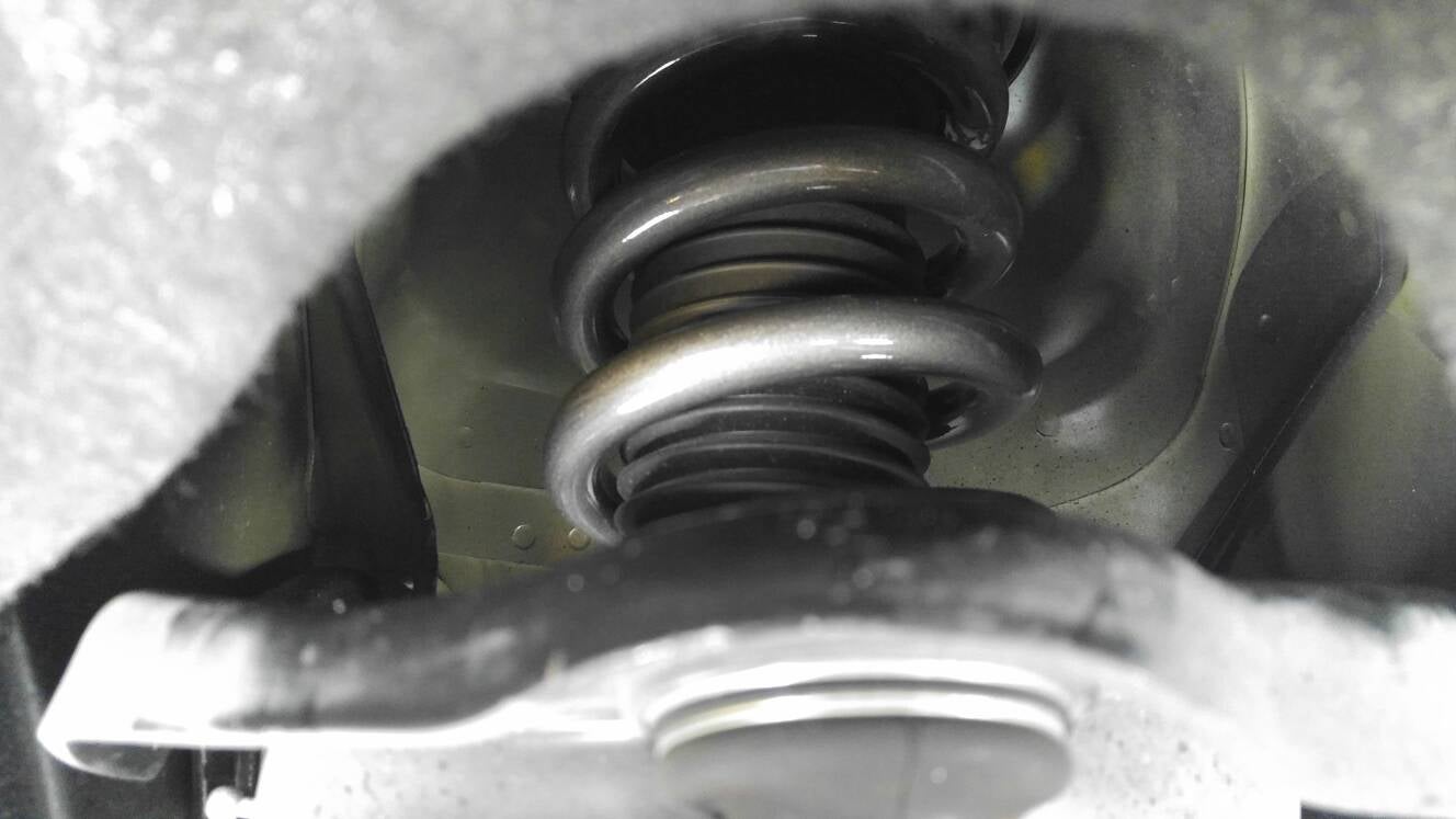

Here is the front spring installed.

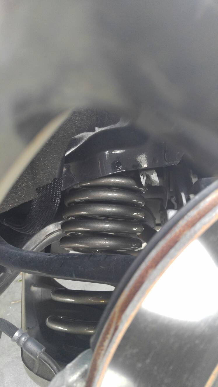

I'm starting to think the springs were mislabeled from RM. They seem to be installed backwards. Based on the springs and the thick wire springs installed in the front.
This is how she sits today. Complete opposite of every other I have seen posted.

RM sent a new set of front springs. Here are the results a few hours later.
Big thanks to Black Ops ( Chad and Josh) and RM for quickly adressing and fixing the issue.
Before with wrong front springs and level ground.
After with new front springs and my driveway (not very level). You get the idea!

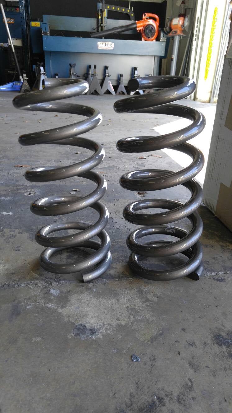

The spring on the right was the wrong springs they sent the first time. Ones on the left the new ones sent.
