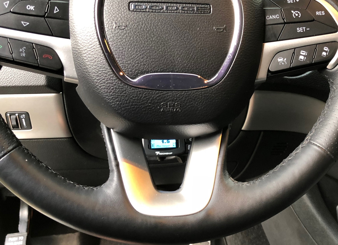

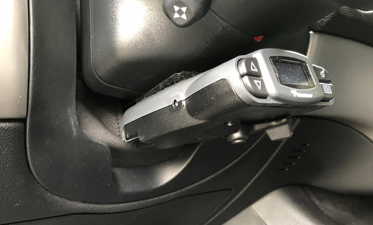

#98 ·
Greetings. Brand new to the forum and pleased to see your set-up. I'm ready to place my order for a new '18 RT after putting a deposit on a new 24' travel trailer. I'll be using a W/D hitch with sway bars but wondering how you like the rear load levelling in conjunction with your set up?
#131 ·
Just an FYI on the rear load leveling when you setup your weight distribution hitch. I use an E2 WDH, and setup instructions said to disable self leveling function. I called Fastaway because the self leveling on the D can't be turned off. The tech told me they have had the best luck bringing the front fender measurement back to or slightly under the orig height for those kinds of vehicles. Manual indicates to bring front measurement 1/2 way back to original. Every WDH setup will be different, but wanted to mention that.

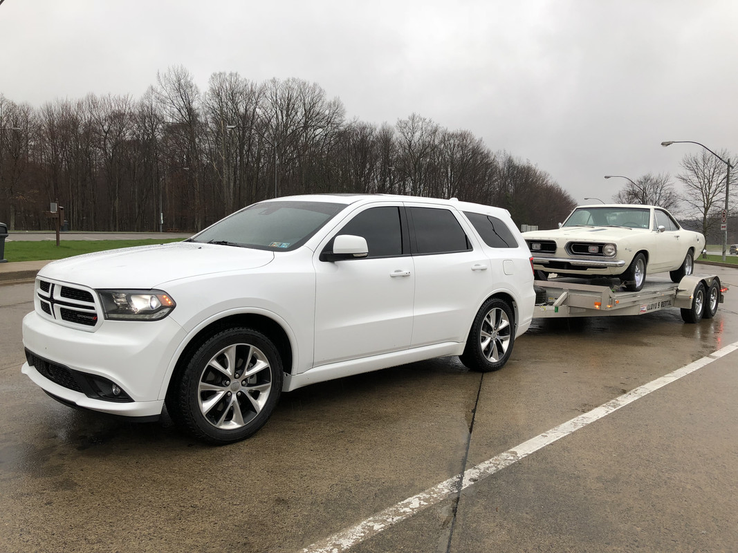

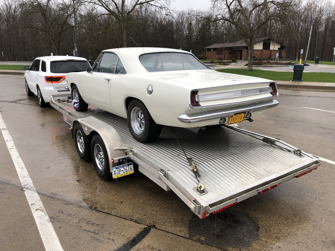

Picking up my wife's little toy.
#101 ·
No issues at all with the lift gate or the lowered suspension towing.
Thanks!!

I suggest getting a sway control stabilizer bar setup. I also had to add the trailer brake controller, super easy, there is already a wire harness for it, you just buy the controller and the connector wire harness. I have a 2016 Durango R/T with the tow package so it has the hydraulic suspension. The stabilizer bar makes a huge difference. When your on the freeway going 60-65 and people blow by you and when your in heavy winds. I never had an issue with my other vehicle towing without the stabilizer setup but the Durango really benefits from it. To explain how it feels when you install it, it is like you are one big long vehicle with your trailer. When you don't have it the trailer can sway back and forth independently from the vehicle and make things feel uncomfortable in heavy winds, wind gusts or when being passed by another vehicle. The freeway is where I noticed the issue when being overtaken by another car in the lane beside you, the air the other car is pushing hit the trailer first and whipped it over then when you feel the tug of the trailer the air from the passing car hits your vehicle, so the that combined with the trailer getting push over really feels uncomfortable to you behind the wheel. I don't have any issue with that now. I have also driven in really band winds and it wasn't really bad at all. Plenty of power with the HEMI. We are coming up on our second year of ownership and still love the Durango. This is what I have towed so far:
