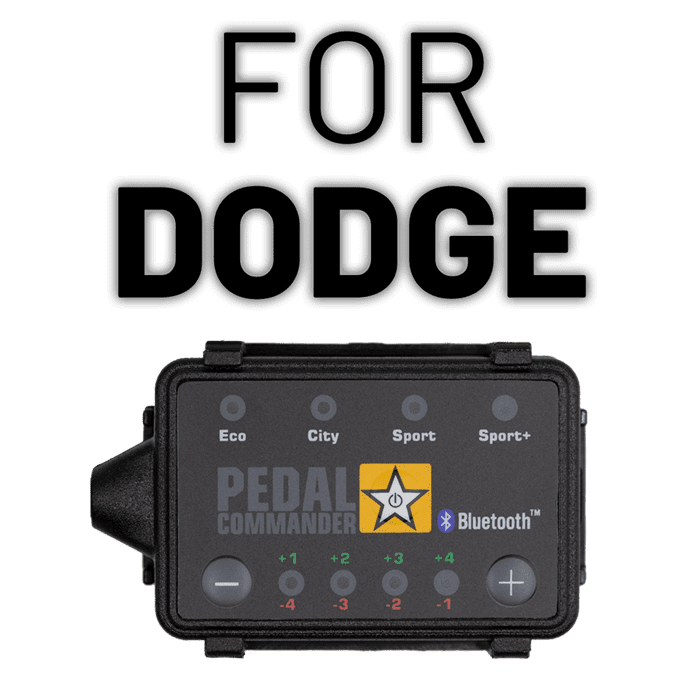

True , i know in traffic today it’s sitting around 13-1500rpm.. maybe i need to make some further adjustments to the PC, same before without the PC but it feels like no in between of low end and to high end power
