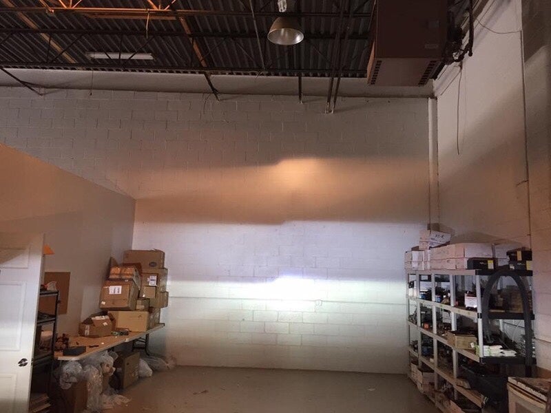

Pic to show how bad led bulbs are in headlights.
