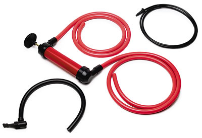

Can anyone recommend a good fluid transfer pump? I just used mine for the first time, it's been sitting in my garage for about 5 years, lol. It absolutely sucks! I'm looking at getting something like this:
It looks like that'll work much better than mine. Mine has a hand squeeze bulb to pump the fluid so, in order to transfer it, I had to pinch off the tube going to the diff to suck fluid out of the bottle, then let go and pinch the tube going to the bottle to squeeze fluid into the diff. That probably took me a good 1/2 hour alone! Fun stuff.
I bought something similar but found that the screw-on to the bottle was the wide neck one and both the ATF+4 as well as the Royal Purple containers for the rear diff use the narrow neck bottles. A real pain to transfer any other way as squeezing the bottles isn't an option unless you want to lubricate the pavement :naughty:. I used two old Mobil-1 bottles duly rinsed and now have one for the ATF and one for the RP.

That type of manual pump is a fine design, but spend a few more bucks and get a brass bodied one (ITT/Jabsco.) They last forever.

I have the pump pictured above and wouldn't dare call it great, but I don't know how I'd have gotten the diffs filled without one.
The major problem was the pump wasn't very efficient and seemed to have a lot of blow-by. By the looks of it you'd think you'd be able to pump a significant amount in one movement of the pump? wrong! You had to really work to get it pumping but, after it was done, it was alright.
I think it'd be much better if the pump were a bit smaller. I'll bet the brass pump is waayy better than this one.

Thanks for the replies, guys! I'll look into a brass bodied pump, then.
LOL at the big brother stuff.
How easy are those brass pumps to clean and what's the price? Reason I ask about the cleaning is that using it for both the ATF+4 and the diff fluid you don't want to contaminate one with the other.

Thanx Tom. The cleaning was as you normally do the transfer case and diffs at the same time, you don't want to run 75-90w through it and then suck up ATF+4. I have two separate plastic hoses but the body of the pump is still hard to get clean?
greg
I have one of those type as well as the other and it's real messy.
Clean up is a snap, just unscrew and run a rag thru it.
