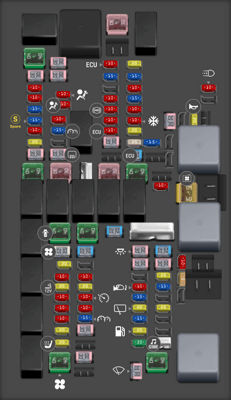

3) If the air bag fuses are removed from the fuse box will the air bag light come on ?

Simple removal of the fuse should trigger the warning light.

The air bags did not fire. The wife is saying something about fuses being too small. They bought the vehicle used, was driven by the dealer's wife, kinda as a demo unit. No accident history that can be found.
