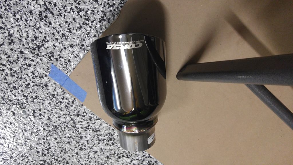

I have them posted in my intro thread... It's like a black chrome. Very clean looking and the Corsa logo looks awesome. Hopefully the logo won't discolor.
I also have the black top edition - black grille, rear view mirrors and black wheels. Black tips seems to complete the package. I think I'm going to paint the brake calipers black as well... (maybe red).
