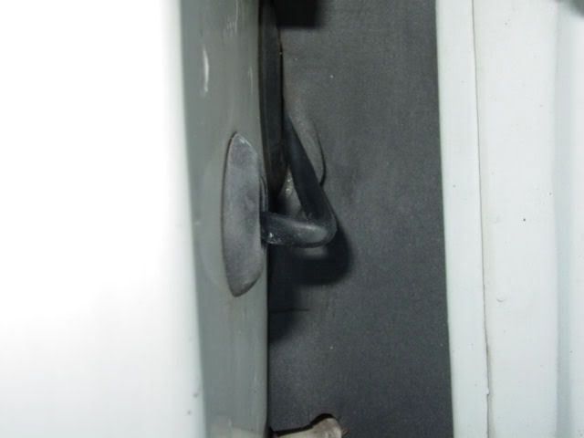

Getting it ready to pull through with old cable
Pulled old cable and boot out
A little pulling and the new one comes through
Pushed it through the side panel

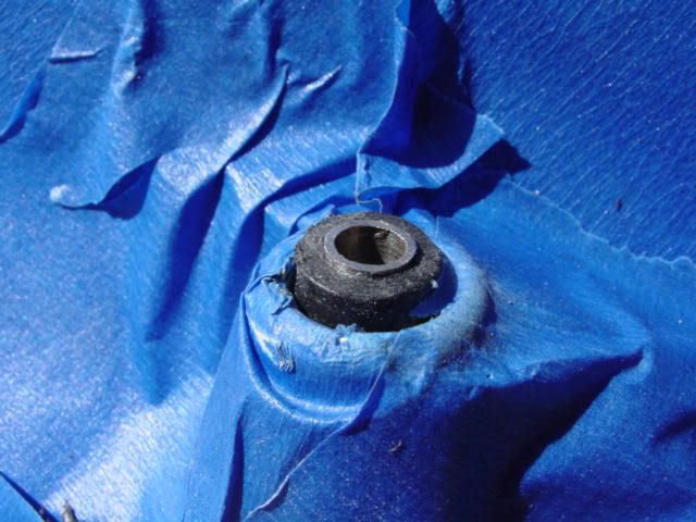

Pushed new boot in place

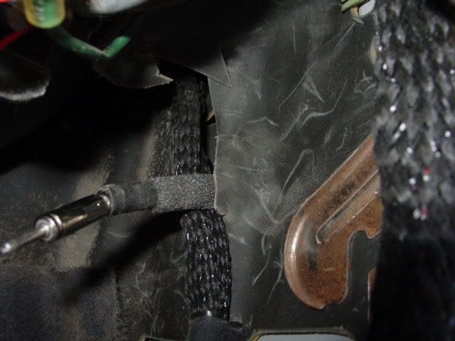

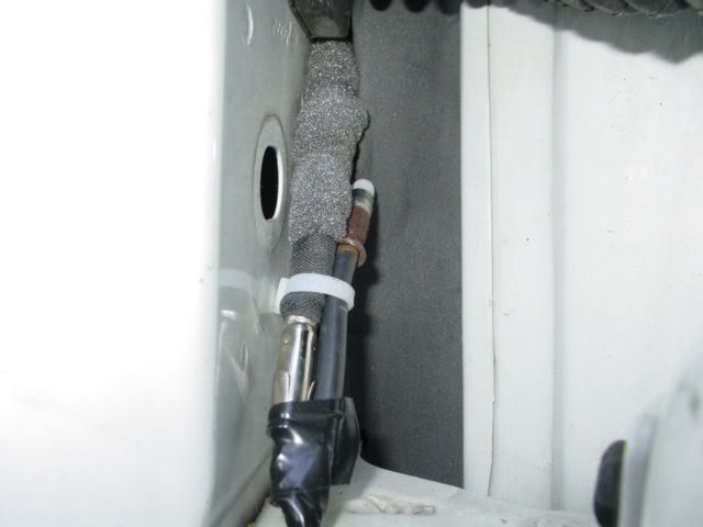

Connected it to existing cable behind glove box

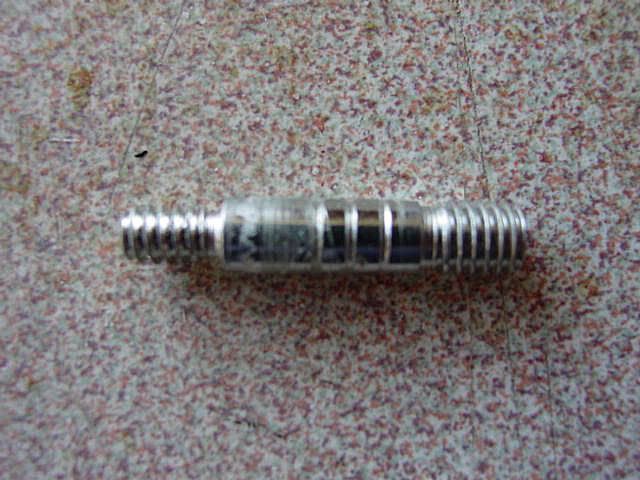

Universal kit I picked up, it cost $5.15 total
Stud from kit, it came with 3 studs

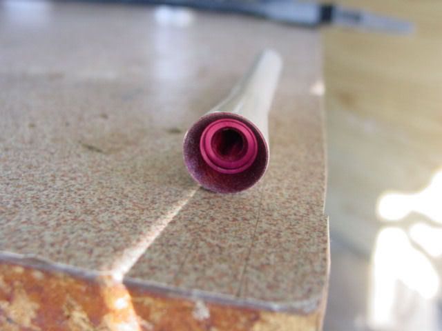

New antenna, as you can see I painted it white to match the D. I should have known better to order anodized red as it always looks violet to me
Inside showing true color

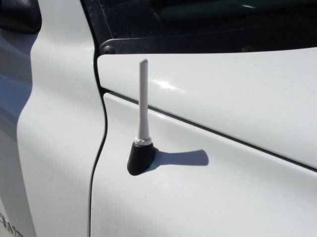

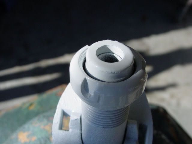

Got the new antenna on today.
The chrome piece that I painted white. Not sure I like this look, might have to go and order a new one and leave it chrome.
Place the antenna on it and you can see a gap

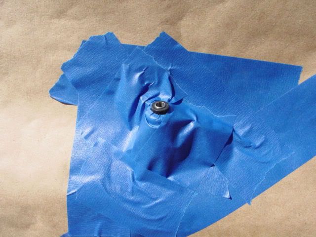

Masked it off so I could use the angle grinder and take the black piece down some so I won't have a gap.
Afterwards and with some trimming to get it back to what it looked like before
Antenna screwed down nice and tight to the white piece. I'll give it a few days or so to see if it grows on me. If not, like I said I'll just order a new chrome piece and leave it chrome.

I think It looks Good
#19 ·
Thanks! I do love the look of it overall. I keep looking out my front window at it while I'm driving.

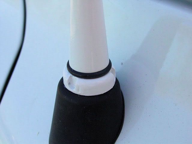

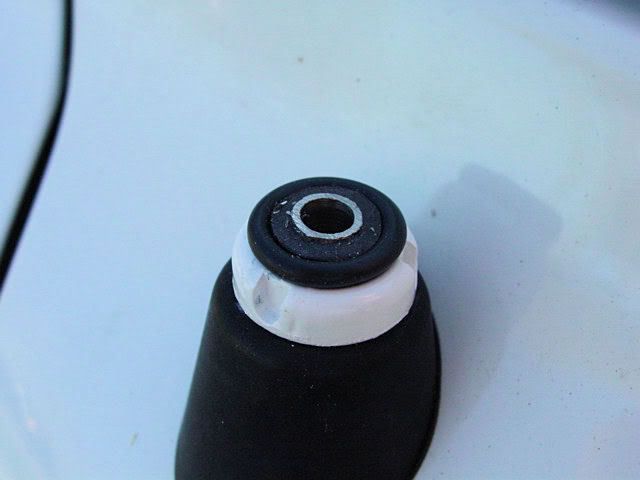

Now a little update: Since the bottom of the antenna was touching the white piece, it was grounding out and not getting a reception. So I had to add a rubber piece inbetween them.
A number #9 O-Ring fit perfectly

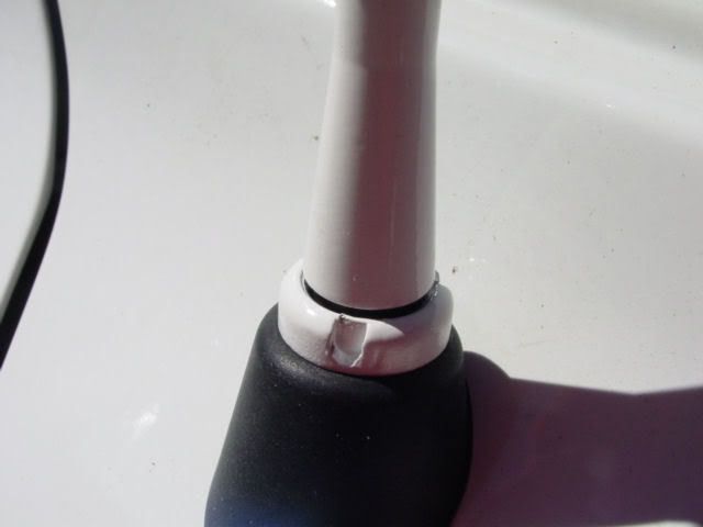

Here it's in place
With the antenna screwed down. if you go this route, just don't over tighten as you might end up squeezing the O-Ring out of place. I got it tightened down real good though without a problem. It's not as noticeable in person as in the closeup pic.
The O-ring on the end BEFORE the grind down would have been the perfect ticket. The alternating white, black, white, black? and the size changes between each part works well. If you replace it again for another $12, I'd paint it again and use the ring from the get-go.
I think the antenna is perfect for a few channels when matched to a Sirius Radio, etc for the heavy lifting. I've ran 18" down to that size for years so I never got great regular radio reception.
