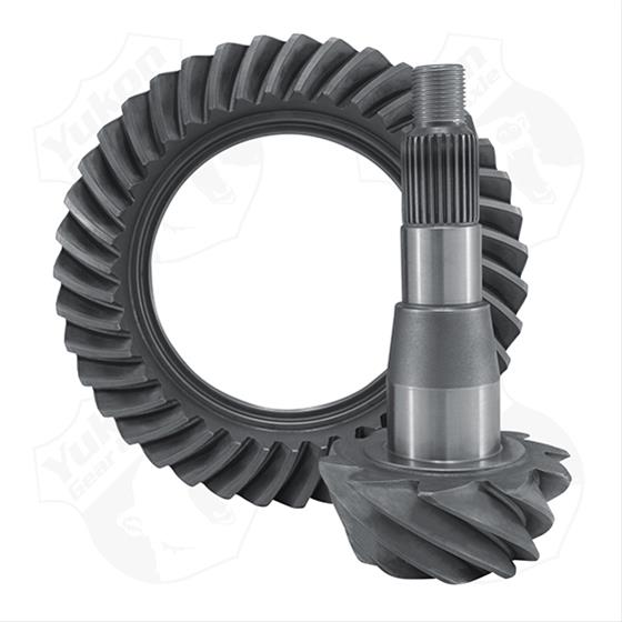

190 Posts
This is the ring for the rear, do they make a matching for the front?
Sent from my SM-G975U using Tapatalk
