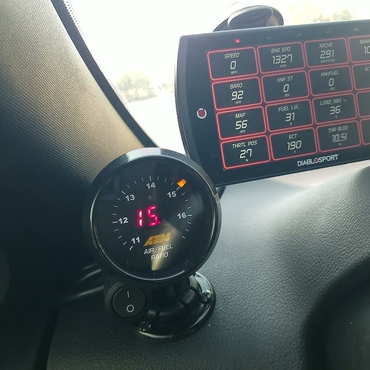

421 Posts
I’m going to strap a gopro to the steering wheel and film the tach and speedo tomorrow to see when its shifting because i dont look when I’m driving lol
You can here it in the video. Sounds like the stock 5500 rpms or so.
Just a quick vid after I first put the cam in getting the afr dialed in. Was 90 something out side. That's a 6400 shift. The 6000 shift from before the cam sounds different than stock too.
