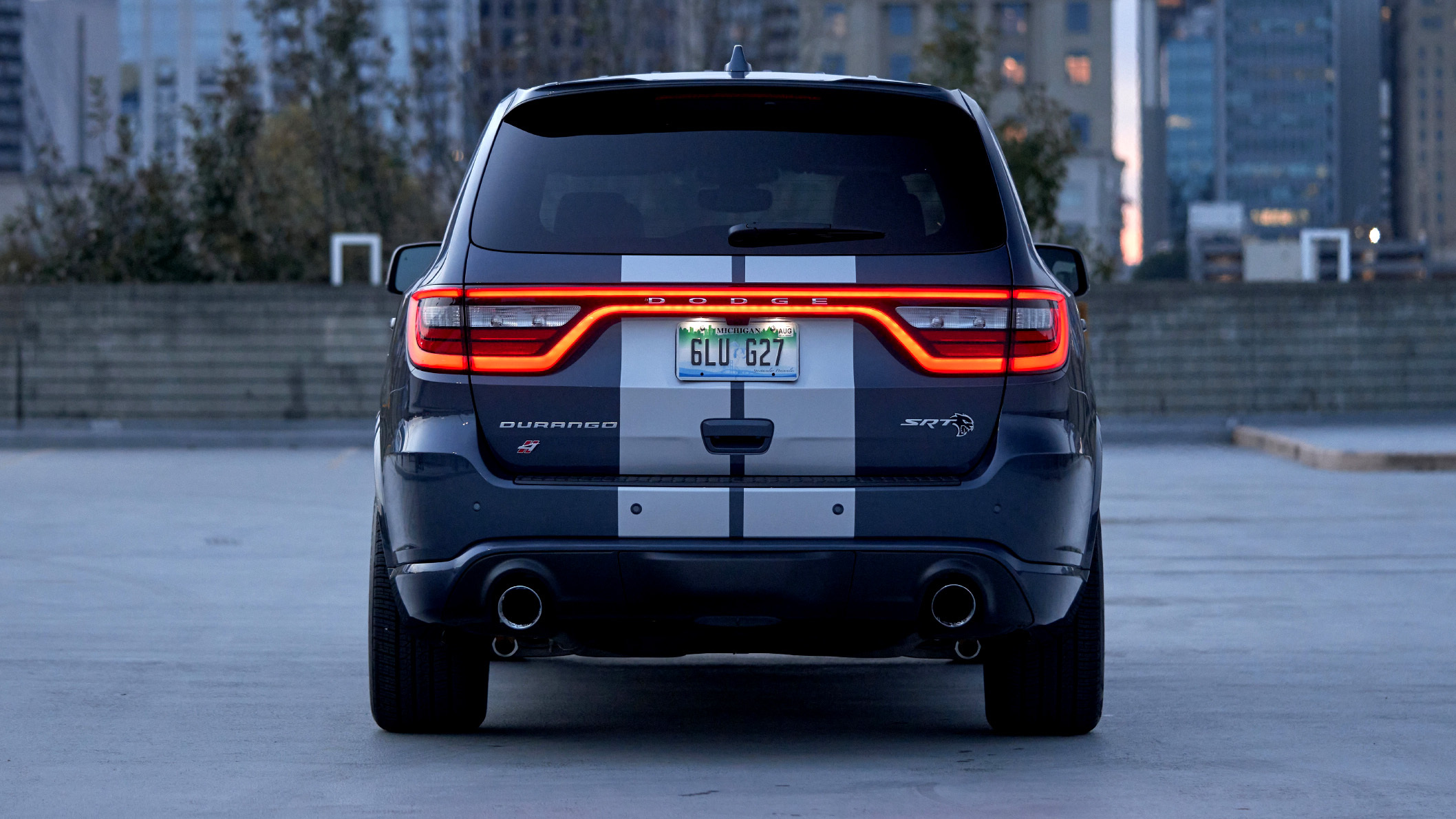

I did get the racetrack tail light replaced under maxcare about five years ago.
I've been wondering if it could have been possible for Maxcare to replace ours as well back then if we were having the same problems. Just recently we started having the blackout problems. If there ever was a time when Max care did replace them I think that ship has sailed.
From this day forward, if anyone know a person, man or woman who has a Maxcare replacement of the racetrac light, please elaborate how? We need answers.👍
I would tend to agree with you about getting it covered today. I sealed mine with exterior black caulking a few years ago and removed the two screws inside the hatch for drainage. Has been good so far. If it fails again, I'd disconnect the whole thing. When I was looking for an SUV, the only thing I really didn't like about the Durango was the racetrack light lol.
Has anyone tried the aftermarket versions that I’m seeing on Amazon and eBay for a couple of hundred bucks?
If you can find one cheap I'd definitely try it. For $600-700 (what I see) I'd probably just spring for a new OEM one at $1000 and seal it up tight beforr installing it.
Actually, I'd just live with annoyance for $1000, but for a couple hundred I'd buy a new one!
