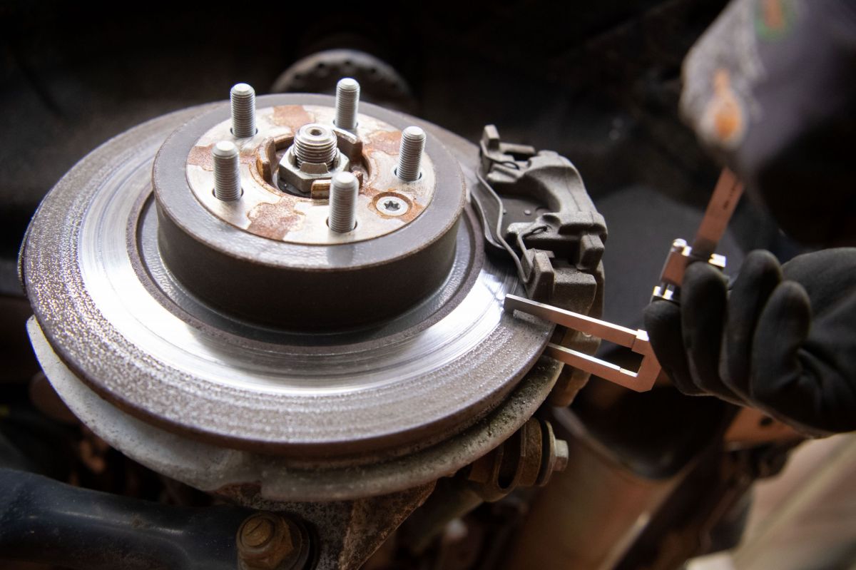

On my 2021 Dodge Durango with Brembo Brakes I had to replace my brake pads at 20K and they were pretty much wore out. Couple things I want to note. I never towed anything up to that point and I don't drive the vehicle very hard. In all the new vehicles purchased in recent history, including a GT 500 Mustang Shelby and a Dodge Challenger SRT8 I never replaced brakes that soon. What's really unusual is the rear brake pads were worst than the front. That part I figured out as most newer vehicles are setup to engage the rear brakes first to eliminate nose dives.
The second part of why they wore out so quickly took a bit longer to figure out. Went to my dealer and they did not have a clue as to why. Giving it some more thought I came up with a theory. My vehicle has all the technology stuff including adaptive cruise control which I used all the time. Started thinking how the car keeps slowing down to adjust the speed?Then it hit me... they are constantly using the brakes and cruise control to adjust the speed. Went back to the dealership and ran it by them and they agreed with the idea.
The next point I want to make is the cost of replacing the pads with factory parts (most likely made by Brembo). Retail price on front and rear pad are over $1250 plus tax. Here is where I decided to look for a lower cost alternative. Power Stop makes great pads for a fraction of the cost. They provided me with the part #'s of their product and found them on Rockauto delivered to my door for $117 total for all 4 wheels. According to everything I read you give up a bit of cold stopping power but everything else is excellent with virtually no dust on the calipers or wheels. I elected not to replace the Rotors since they were perfect and are working just fine. Changing just the pads on the RT is a piece of cake and you can view it on a U-tube video. Hope this might help you if you experienced a similar situation.

To the OP I don't know why your rear pads were worn more than your fronts...but that is not normal. It would only make sense If your car was older/used and previous owner changed front pads only and the rears would be twice as old. Your conjecture that the car is designed to have higher brake force in the rear to reduce front "dive" is incorrect.All cars are designed for more front brake bias..it is safer and allows the driver some control under heavy braking along with abs to steer the vehicle...having too much rear bias would put many drivers in the weeds...Formula 1 drivers are the best in the world and If they get more rear bias even they can spin..

I just wanted to say my rear pads are up for replacement at 17k (under 3mm now) and the fronts still have a lot left. I don’t know why that is the case but my rear brakes appear to be wearing quicker than the front as well. 😳

Do you use Adaptive Cruise Control frequently? According to some reports, ACC primarily uses the rear brakes for speed control.

Oddly enough I think there are some vehicles where this is the case. I have a good friend with a C63AMG (RWD) and it uses the rear brakes as part of traction/stability (which the car can't hook up to save itself, it might even use them as a side to side virtual positraction or something) and it goes through them at 15-20k with the rears going faster than the fronts.
Reactions: 1
Actually I do.. that would make a lot of sense.
