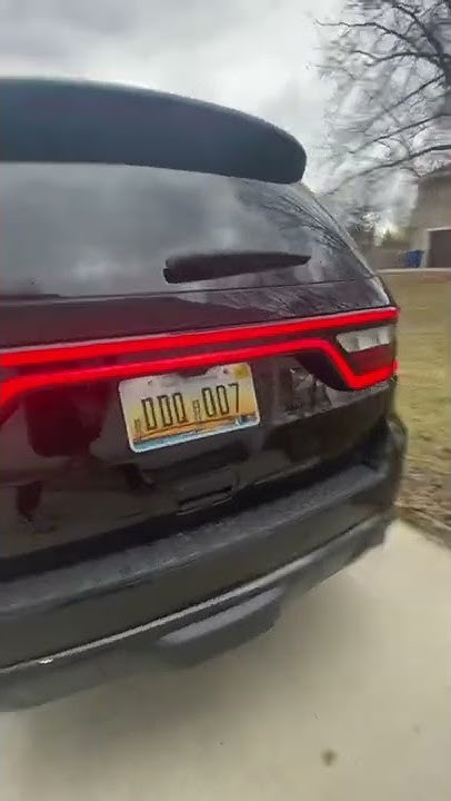

It’s rainy af here. Drove it home last night( took an Uner there, about 20miles) took the long way of course. It definitely rips. Ecu has to learn apparently. She was a bit jerky on tip-in. Smoothed out today. Stage 2 heads and stage 2 Hellcat cam. Surprised it made that much power. I’ll post videos and tickets soon!
View attachment 120751 View attachment 120756
