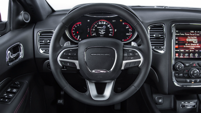

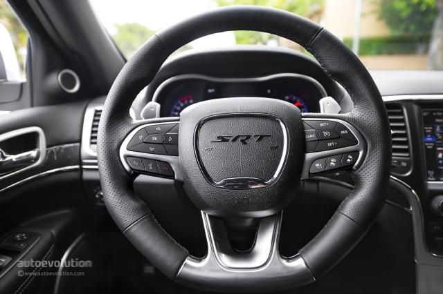

Anyone know if the steering wheel from a 2014 SRT8 Grand Cherokee will fit on our 2014 Durangos? I got some seat time in a Grand Chrokee and absolutely loved how the steering wheel felt. The airbag and buttons look the same, just wondering if the actual steering wheel is interchangeable.
Post pics of both straight on let's take a look
Yeah it looks like it will work

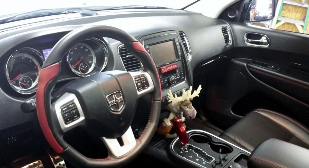

I used a SRT8 Challenger wheel in my D
The process to change it is not difficult but tedious and care need to be taken
Disconnect Battery before you start.
When you get the wheel, you will utilize almost all your plastic trim pieces from wheel

That is the swap I did going to the red one.
20-25 mins max.
