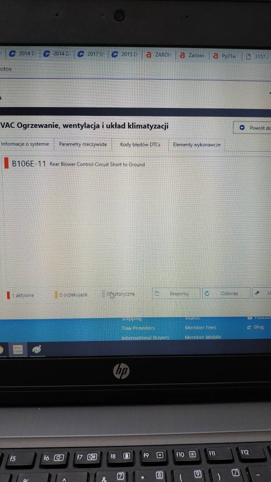

Hello. I have a problem on my Durango 2011. Rear HVAC doesn't work. I checked rear blower and resistor, everything works fine. I see B106E-11 error but i can't find where is problem
M34 fuse. That should be blown. I will lookup the two relays tomorrow which could be the cause of that fuse to blow.with the rear controller disconnected, the error still showing. Did you think that front controller may be damaged ?
If it is a short to ground a fuse has to blow. There shouldn't be any circuits without going through fuses.All fuses are good.
Also is this a stored code or active code. If its a stored code, it could be at some point a component shorted out and someone replaced it. forgot to clear the codes after replacing the component.If it is a short to ground a fuse has to blow. There shouldn't be any circuits without going through fuses.
