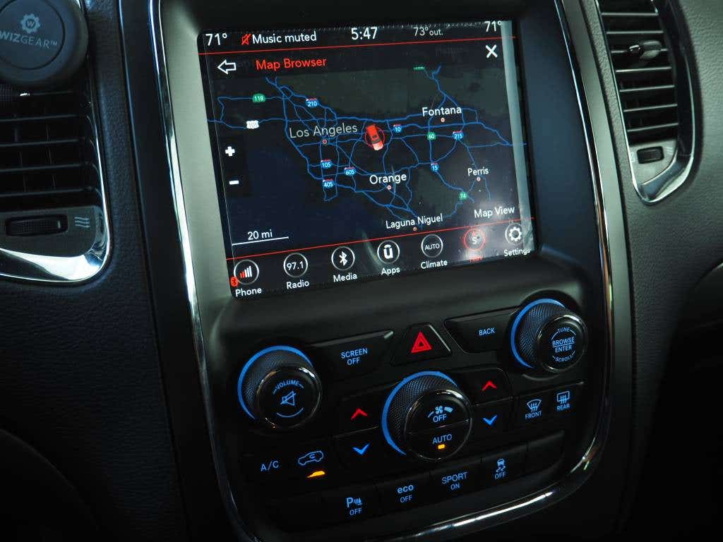

I finally got my hands on a new UConnect 8.4 4C UAQ system. The one that comes standard on the 2018s. UAQ comes with NAV built in.
Things you'll need:
-Radio
-new usb hub
-7mm socket
-torx screwdriver
-trim removal tool (not necessary)

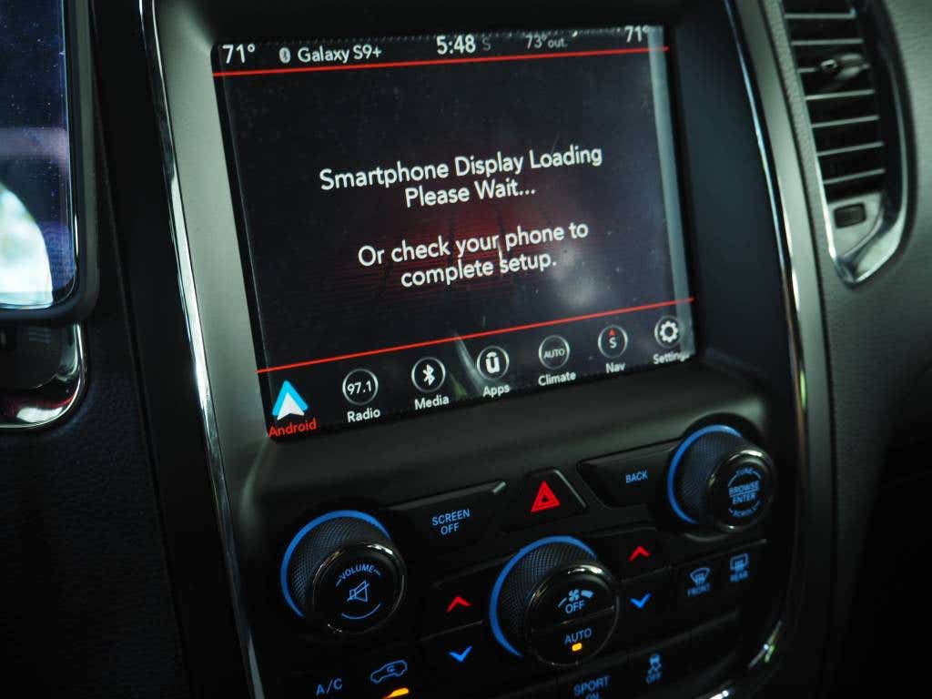

Install took no more than 20mins. 1st time go everything worked. Nav picked up my location right away. The only thing is after installing the radio, I had to let the car "sleep" for 5-10 mins for the radio to acquire all the features the car has (heated and vented seats, sat radio, back up cam, etc)

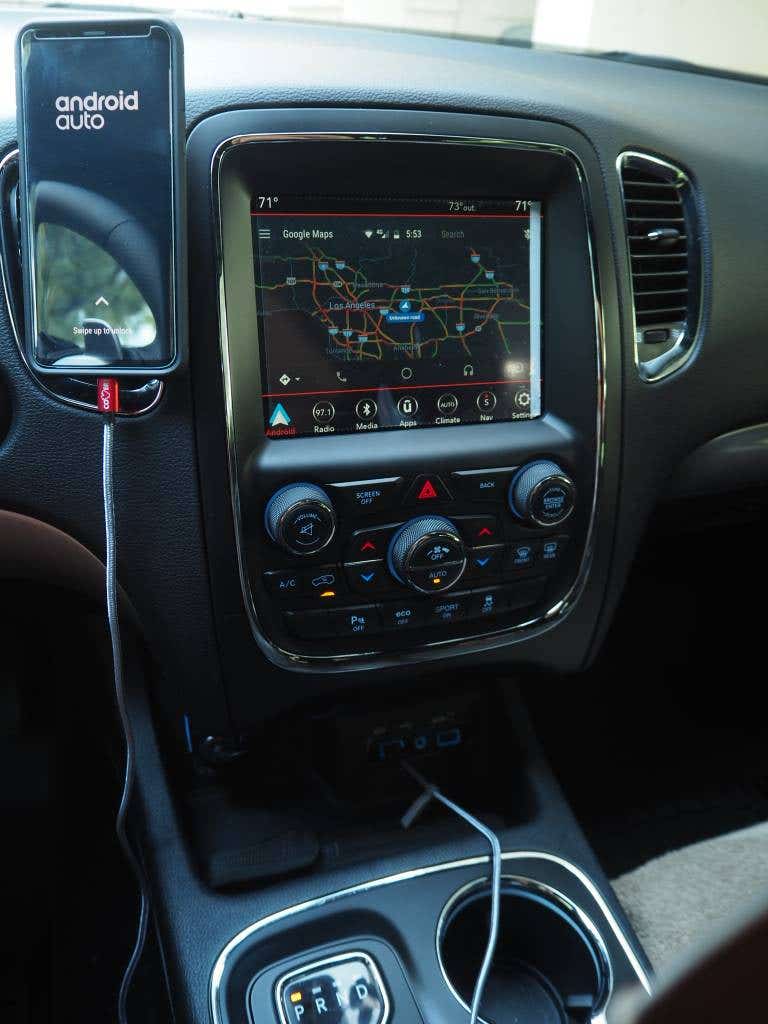

Last thing I had to do was swap out the usb hub for the new one with 2 USB ports. This is necessary for Android auto and Apple Carplay to work. NO way around this. You will need to swap it for this to work. It involved removing the center console and some connectors.
I've been using it for over 2 weeks now and I'm completely happy with it. I retained all the features I had. The stock nav is so much better than my 2017s. Has multitouch capability so you can pinch to zoom. Once I got Android Auto to work, I hardly use the stock nav anymore except for short trips. I just use Google Maps.
It's a big upgrade for me since I love new tech and not having this radio was my biggest disappointment about my 2017.
So now everything's back in order.[emoji108]
